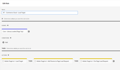

Given that I already have the general Adobe Target Load Rule created...

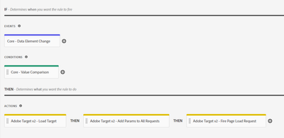

... but the "Library Loaded" event does not work for this specific use case, as the user can interact with the checkbox anytime after the page is loaded, I tried creating a new Rule where I set the event as Data Element Change and the condition as the Data Element being true. I then send the parameter with the Data Element value:
However, this did not seem to work when I tested as this parameter did not show up in the call of the Network tab. Additionally, in order to debug this, I inserted a Custom Code action with a simple console.log("hello world") prior to the "Load Target" action and it worked, so I know my event and conditions are correct.

Update: I was able to pass the new parameter by adding the Data Element value to the first/general Load Target Rule and changing the action in the second Rule as Trigger View. I've also removed my condition as I want to know when the check is false as well, so now I can see a call every time the user interacts with the checkbox.
However, the value of the parameter seems to be the same in every call (true) and I know my Data Element is correct since:
1. My trigger is based on the Data Element Change;
2. I've added a console.log to see the value of the Data Element before each Trigger View.
I'm a bit new to this terms but isn't the Trigger View call supposed to update the parameters values when sending them?
