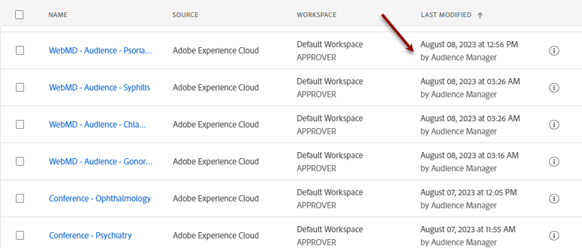

We have set up the back-end integration between Target and AAM (and Adobe Analytics). The AAM audiences automatically show up in Target under Audiences. They can be used in Target like your made-in-Target audiences. Here is a screenshot:
@RobertBlakeley  Thanks, But how to bring GA segments or data to the Audience Manager?
