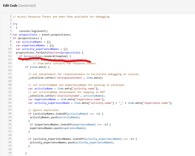

Hi all
We are currently running our Adobe Target via WebSDK, while the integration is done via Adobe Tags (Adobe Launch).
We would like to leverage response token to pass the Adobe Target experience data to Google Analytics like it's suggested here:
https://experienceleague.adobe.com/en/docs/target/using/administer/response-tokens
Our questions:
Thanks!!!!
