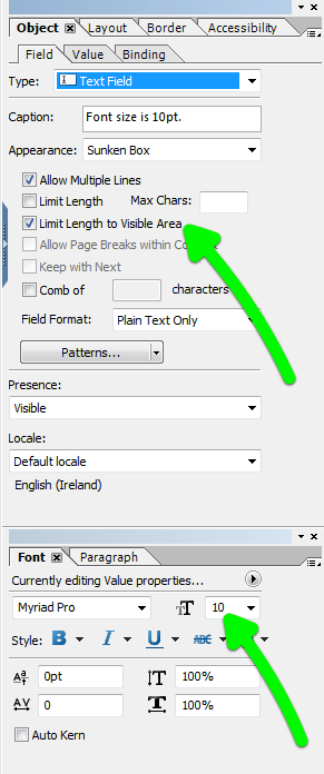

OK,
This contains a second sample, where the textfield is set to 10pt and limits content to visible area:
But in this case the script is in the full event - setting the font to 0pt.
However it is not smooth - the user gets a beep when the field is full and has to exit and go back into the field to get the text to reduce in size.
This is as far as I can take it.
Hope that helps,
Niall
