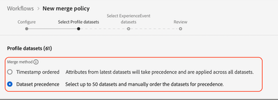

In AEP, we only have 2 options/ways to define the construction of profile unification:
  • Tiimestamp based
  • Dataset precedence
In this testing, based on the selected merge policy (Dataset precedence), the Dataset 1 wins (as it has highest precedence). As, in Dataset 1, "field 2" is NULL, the unified profile will not have this "field 2". This is how "Dataset precedence" works.
