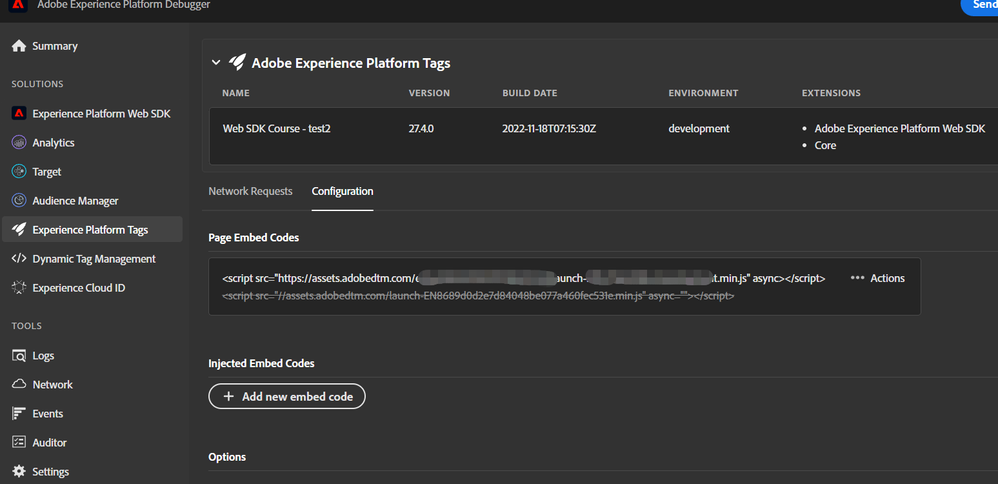

I have change the Page Embed Codes in debugger.
And the post body I can see the identityMap with values.

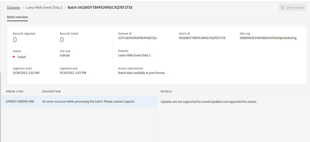

It seems like you have confirmed that your data is streaming into the correct Platform sandbox and your schema and dataset are enabled for Profile. The customer id is being set correctly in the identity map, but for some reason profiles are not being created in profile.
I'm not sure what that the error "Updates are not supported for events" means.  My best guess is that it might think you are sending events with the same event "_id" field twice, but I don't understand how that would happen. You just followed the directions of the tutorial and are you just browsing the site normally, right? From your screenshot, it looks like this might be related to the data landing in the profile.
At this point, i suggest opening a ticket with client care to see if they can help explain what that error message "Updates are not supported for events" means.

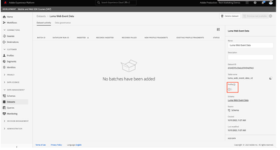

@Tai888 Have you enabled the data set and schema for profiling?
Hi AvinashGupta01,
Yes I have enabled profile in dataset and schema.

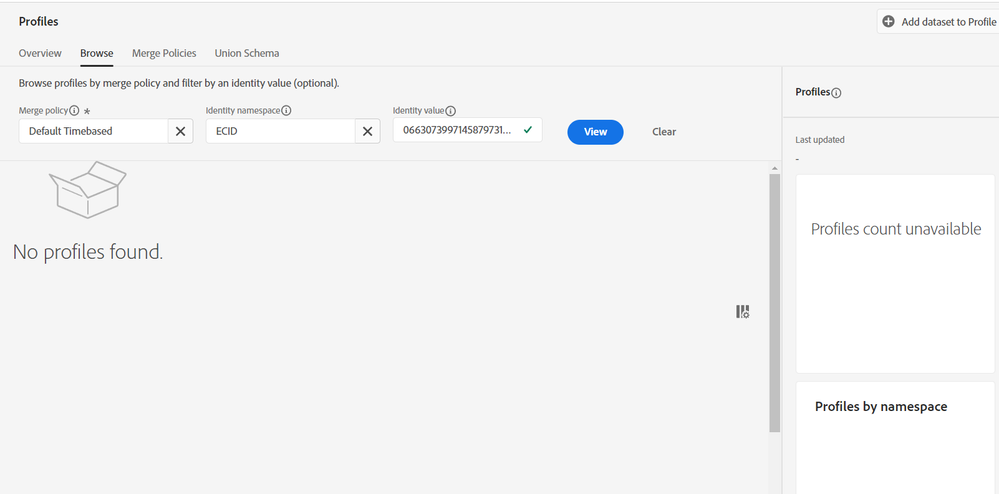

Here are some other things to double-check:
1. Look up the profile using the ECID. The ECID can be found in the _response_ of the interact call in your browser console.
2. Make sure the identity symbol you are passing in the call "lumaCrmId2" matches that of the identity namespace you are looking up.
3. Does a profile count show in the sidebar of the Profiles browse screen?
4. Do any sample profiles show on the Profiles browse screen?
5. In the dataset, if you click the Preview Dataset button on the top right corner, do you see some of your test data there?

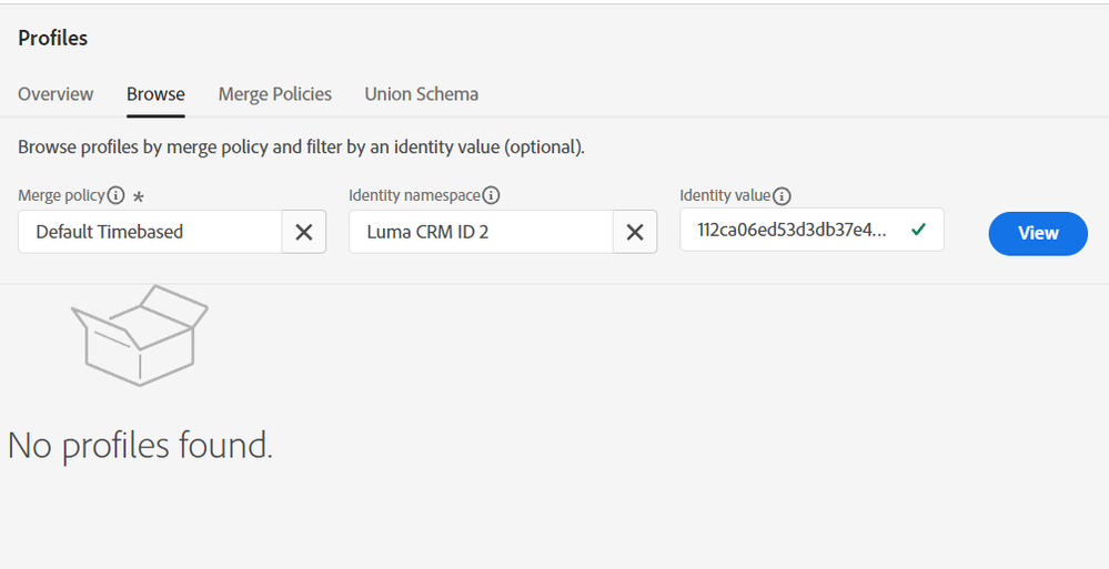

Hi dwright,
Thanks for your help. For your question I check and the result like these:

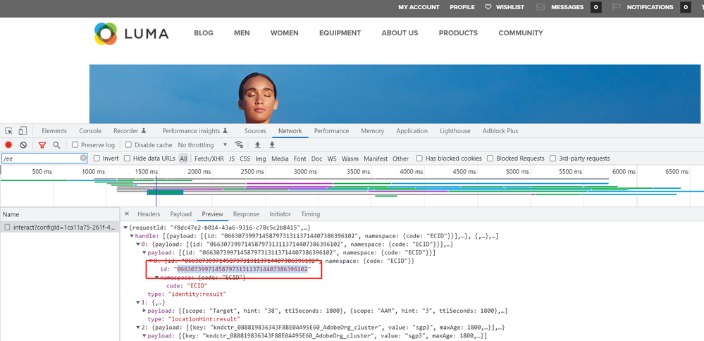

Is this the ECID? I add this to search in profiles and can see nothing.

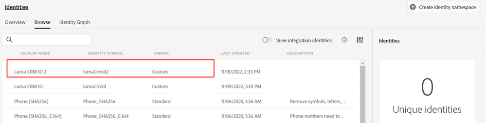

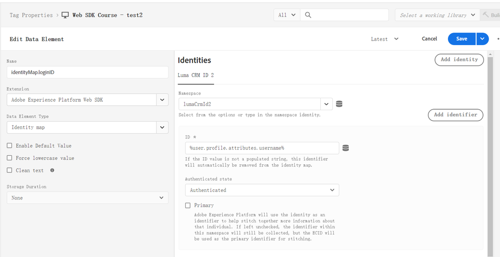

Both in AEP or launch I can see the Identities like this,I think they are matching.
In both sidebar and browse screen there are nothing.

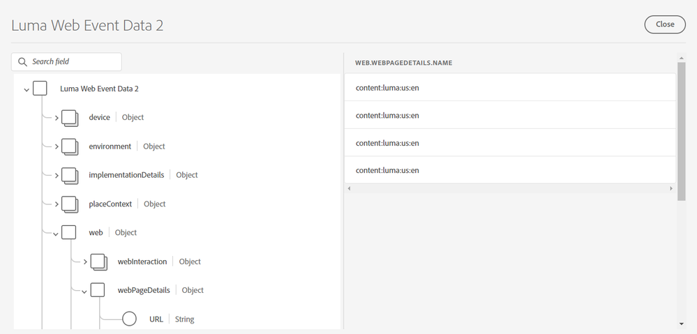

I can see other data like web.webPageDetails.name, but nothing in
Yes, that is the ECID that you found in the response. Thanks for checking that.

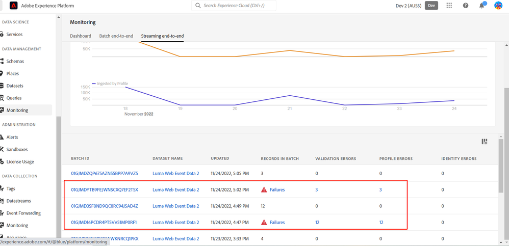

Hello @Tai888
Have you selected the correct profile dataset in the Datastream? if the profile data set is correct then the next step would be to check the activity tab of your dataset for any ingestion failures.
     Manoj
     Find me on LinkedIn
Hi Manoj_Kumar_,
Thanks, I check and found I haven't add profile dataset in the Datastream so I add it.
And I try again, found there are errors in the screen. Do you know how to solve them?
Hello @Tai888
Now check your JSON payload, It should match the XDM structure of the schema. Any difference in payload and XDM structure will cause the ingestion failure.

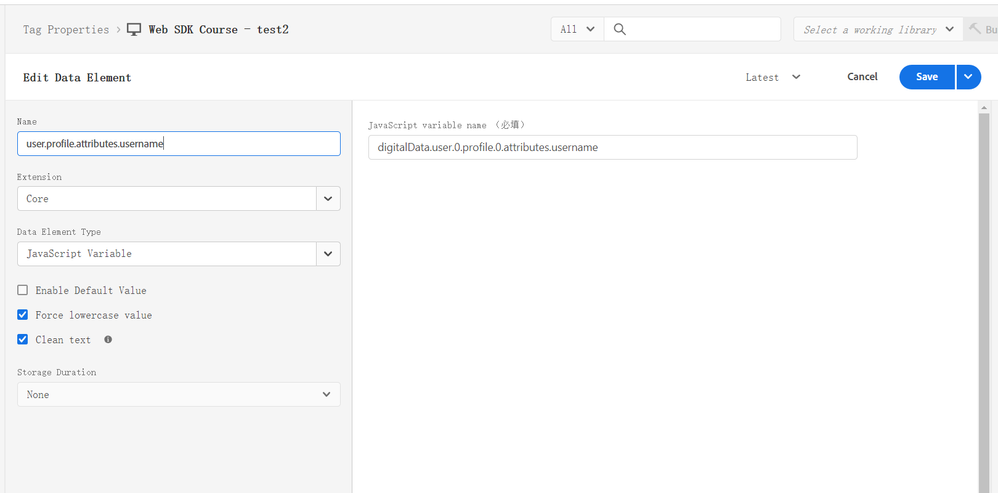

Hi Manoj_Kumar_,
I am not sure what "JSON payload" mean, is this the digital data?
If yes, I think there maybe no different.

And I check in launch, do you mean this?
