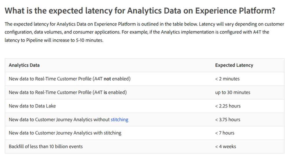

Hi @Michael_Soprano ,
What is the latency for AA as a source to CDP?
  1. https://experienceleague.adobe.com/en/docs/experience-platform/sources/connectors/adobe-applications...
  2. https://experienceleague.adobe.com/en/docs/analytics/technotes/latency
Adobe-Analytics-Source-Connector-for-Report-Suite-Data-Adobe-Experience-Platform-05-19-2025_05_05_PM.png
I know that Web SDK is real-time and would like to know how it compares to Web SDK.
Web SDK to AEP mostly real time, while with AA mediator latency may be in place.
Is it possible to track web data through Web SDK send it to Analytics and then use it as AA as source to AEP?
Yes, it's possible but extra latency might be there. But still you can go through below.
