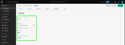

Hello @raphaell3678617 ,
Can you check your date time field form BigQuery table is mapped correctly with the datetime filed in AEP during the mapping?

Hi Parvesh,
Thank you for replying, and I'm sorry I didn't reply sooner.
The example you gave above appears to use an XDM Individual Profile. However, I'm trying to use an XDM ExperienceEvent. If Adobe mandates the inclusion of specific fields like _repo.createDate or any other required fields for incremental processing, I believe that might explain the issue. However, if these fields are not a deciding factor, I can confirm that the BigQuery table is correctly mapped, including the datetime field in AEP.
Please let me know if additional prerequisites or specific fields need to be included when working with an XDM ExperienceEvent. And thank you very much for taking the time to reply!
