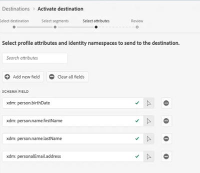

I would like to send some audiences to DV360 via HTTP API. I can´t do it using the native connection as I want to send hashed emails and this destination does not have it as an option:
Google Display & Video 360 connection | Adobe Experience Platform
I have some questions regarding this implementation:
  1. What endpoint should I use to do it?
  2. I can see that tin the HTTP API I can only chose atributes for the export, but I can't map them, so, is there a way to change the structure of the export? I took this info from the HTTP API docu: HTTP API connection | Adobe Experience Platform

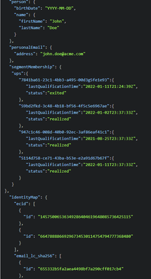

    The output will look like this:
    The question is if DV360 has a specific format for this type of export, would I be able to edit the format of the payload I am sending via this connection?

The output format from AEP is a fixed JSON structure, as specified in the documentation. This format cannot be customized, so your endpoint must be able to handle and parse that exact structure.
