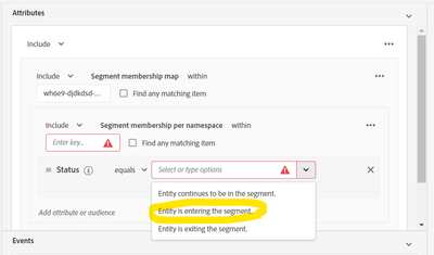

Hi @michaelbailey ,
You can use Status under the Segment Membership attribute and select- "Entity is entering the segment" which means the Profile was "realized", use this as an Include condition
or
select- "Entity continues to be in the segment"  and use this as an Exclude condition:

Hi @michaelbailey ,
or
