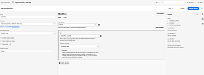

For the web and app (events) I would use IdentityMap.
If the user is not loged in then - ECID primary
If user logs in is it possible to use then email as a Primary?
@bjoern__koth I set up something like this but I do not know how to make a switch.... if the user logs in ... (then Email should become primary)
to my knowledge the ECID is implicitly becoming the primary identity if no other identity is set in the identityMap.
Hence, as soon as you flag your email as primary identity, it should automatically become a non-primary identity.
