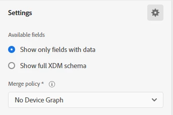

Hi brekrut,
Thanks for revert,
I just want to understand by considering below two scenarios:
Scenario 1: We have one audience including the below two audience.
1. xyz_test audience (“Default-Time-Based”)
2. abc_test audience (“Default-Time-Based”)
Scenario 2: We have another one audience including the below two audience.
1. p_test audience (“No Device Graph”)
Due to both merge policies are different we are getting error.
So, if we change the merge policy of ‘abc_test’ audience from “Default-Time-Based” to “No Device Graph” then we are able to save it.
But if we are changing the merge policy in Scenario 2 for abc_test audience then it will be impact to our existing audience of Scenario 1 it was my understanding.
Please correct me if I am wrong.
below snap for reference
