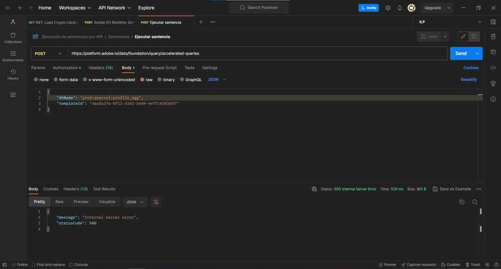

Then, I put the request body:
I get ACCELERATED_STORE_DATABASE and ACCELERATED_STORE_SCHEMA using the following SQL statement:
SHOW SCHEMAS
Query response showed two databases and two schemas:
DATABASESCHEMA
qsaccelprofile_agg
cjm_qsaccelcjm_reporting_aggs
I built the dbName using the following pattern:
{SANDBOX_NAME}:{ACCELERATED_STORE_DATABASE}.{ACCELERATED_STORE_SCHEMA}
When I try to send the request, I get the error:
I also tried to build the dbName using the another database and schema, but it doesn't work. Likewise, I tried to build the dbName using the following pattern:
{SANDBOX_NAME}:{ACCELERATED_STORE_DATABASE}:{ACCELERATED_STORE_SCHEMA}
I tried this one because request sample uses : instead of . on dbName. But when I send the request I get a 500: Internal Server Error:
What am I doing wrong?

A '400 Bad Request' error typically indicates that the server could not understand the request due to invalid syntax. This can often occur because of incorrect headers, query parameters, or body in the HTTP request - please check keys, org id, access token, JSON body and also if you and retry.
Firstly, try endpoint as
https://platform.adobe.io/data/foundation/accelerated-query/queries
Let me know.
Madhan
