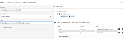

I have created a data element using _satellite.setVar("linkText","clickText") in the custom code of the rule.
Then I am using percent (%) syntax reference this in AEP web SDK update variable type as shown below in eVar50
When I check the value in network call I am seeing it as %linkText%
Can you please guide how we can get the actual value of this data element if I need to update it in the UI.

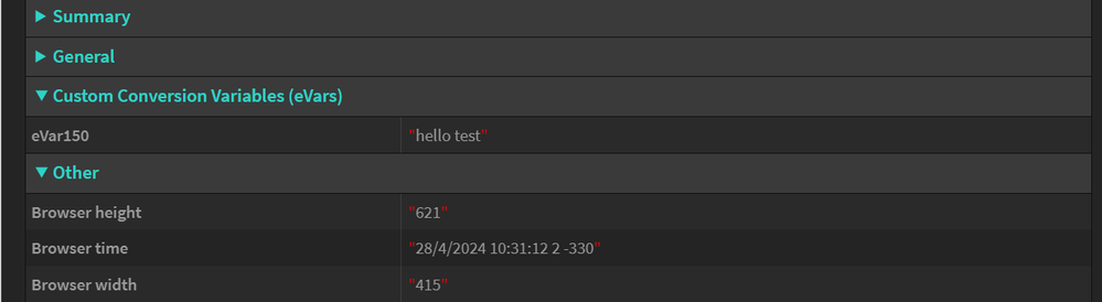

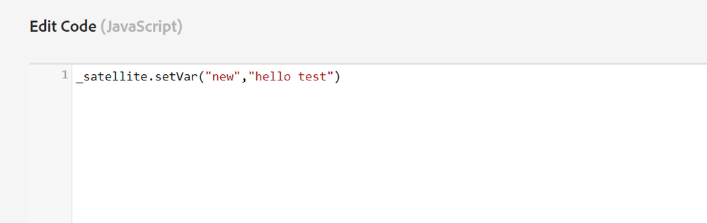

  • a rule to set a data element at page top event using setVar method in custom code.AnkitCh2_0-1716872685416.png

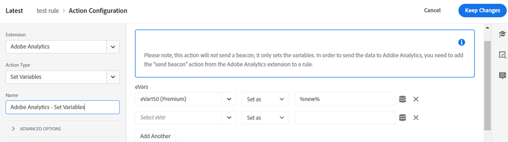

  • another rule at dom ready using set variable UI to fetch the value of data element set in the previous call using setVar.AnkitCh2_1-1716872810359.png
  • I am getting the value in the omnibug call.

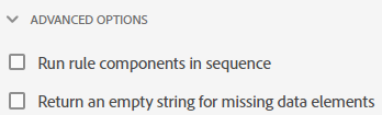

Have you tried delaying the update variable and send event action?
Yes, it worked after applying the delay. Earlier this was disabled on my property settings.

I believe setVar function itself is synchronous however the custom code action defined in the rule is talking more to set the data element meanwhile the next actions are executing and conflicting with it as rule sequencing was not enabled for the property.
Maybe Adobe should rethink their UI a little. If in @ankitagarwal05 's example without sequencing, the actions are separated with "THEN"
whereas with sequencing enabled, it say "WAIT, THEN", both cases sound very similar and may lead to false assumptions.
Maybe in this case, setVar is actually executed in time then, if "update variable" and "send event" are both asynchrously called, the update of the variable likely just has not taken place.
Key takeaway: "run rules in sequence" is your friend not only in this case. Can lead to timing issues in the bigger picture though.
