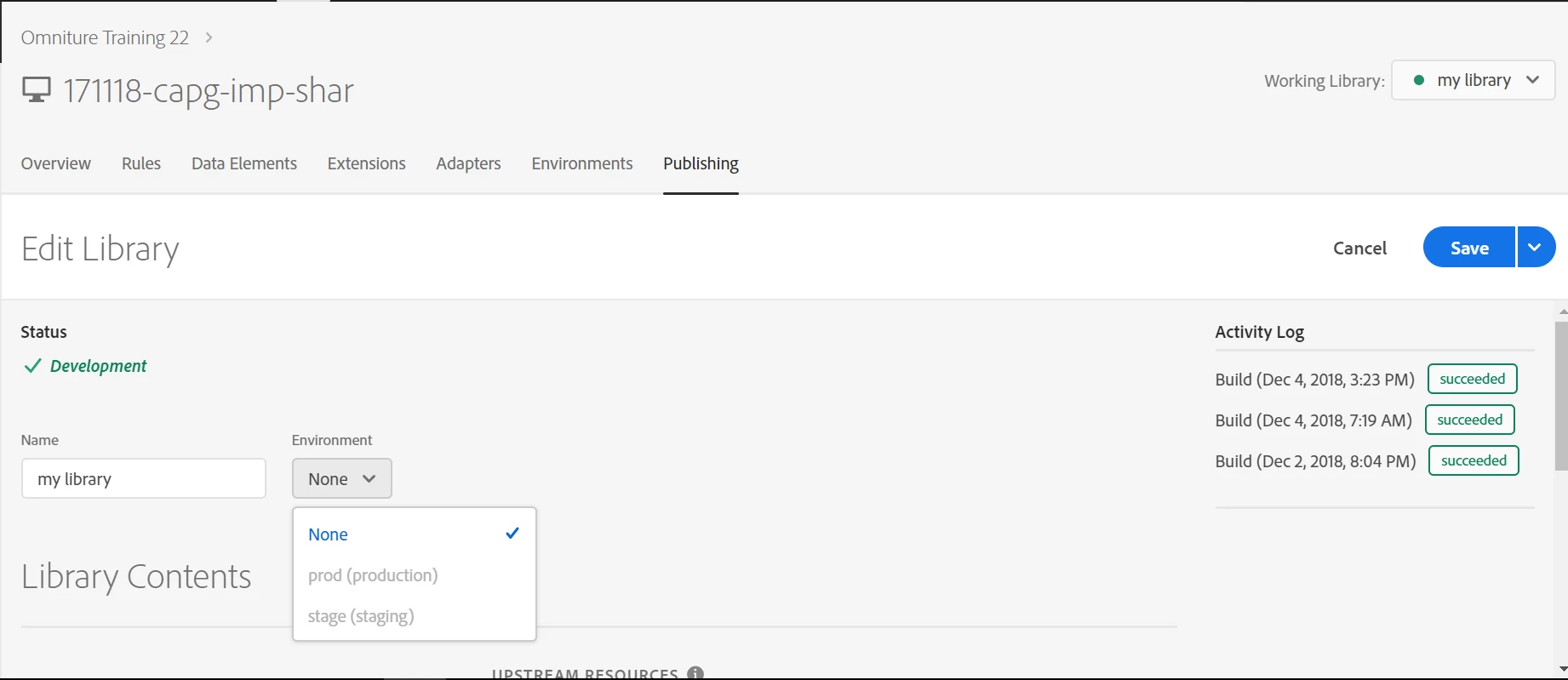

Hi Guys,
My client wants to migrate from DTM to Launch but they want to use the same DTM prod embed code in launch by creating production environment in Launch.
I have already created new production environment in launch using DTM embed code but while publishing it I am creating New Library using prod environment(which i have created using DTM prod embed code) I am getting this environment as inactive in new library dropdown list.
Prod Environment using DTM prod Embed code.
Getting Prod Environment(Embed code copied from DTM prod Embed code) Inactive while creating New Library.
Please suggest to do the needful.
Best answer by Alexis_Cazes_
This is only usefull is you migrate from DTM to Launch.#
In DTM click on the button to migrate to Launch you should a dialog box that asks if you want to use same production as DTM check this.
During migration Launch should create Development, Staging and Production enviroment for you.
You can never link a build to the Stage or Production environment, it should always be a dev one.
Once you finish the development you should push your build for approval which should move it to stage env. Once it is approved and published it will be available in prod env for both the DTM prod location as we decided to link it during migration and the launch one.
