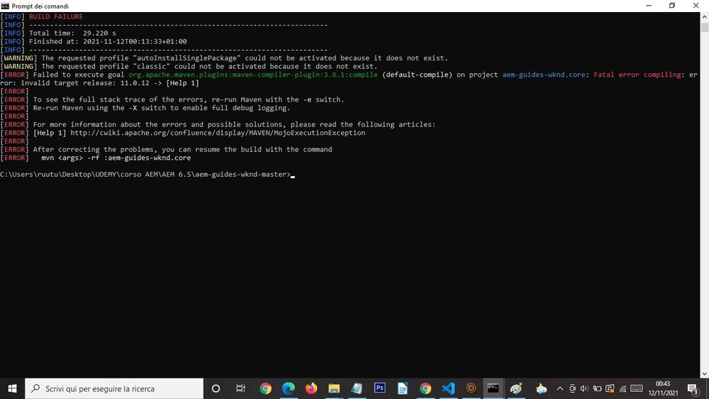

i would to syncronize Visual Code Studio to AEM 6.5, i have followed the instructions of this video
At minute 3:23 of video i should install a package into WKND Sites project - Core with this command, in the terminal of Visual Code:
"-PautoInstallBundle clean install"
but this is the result

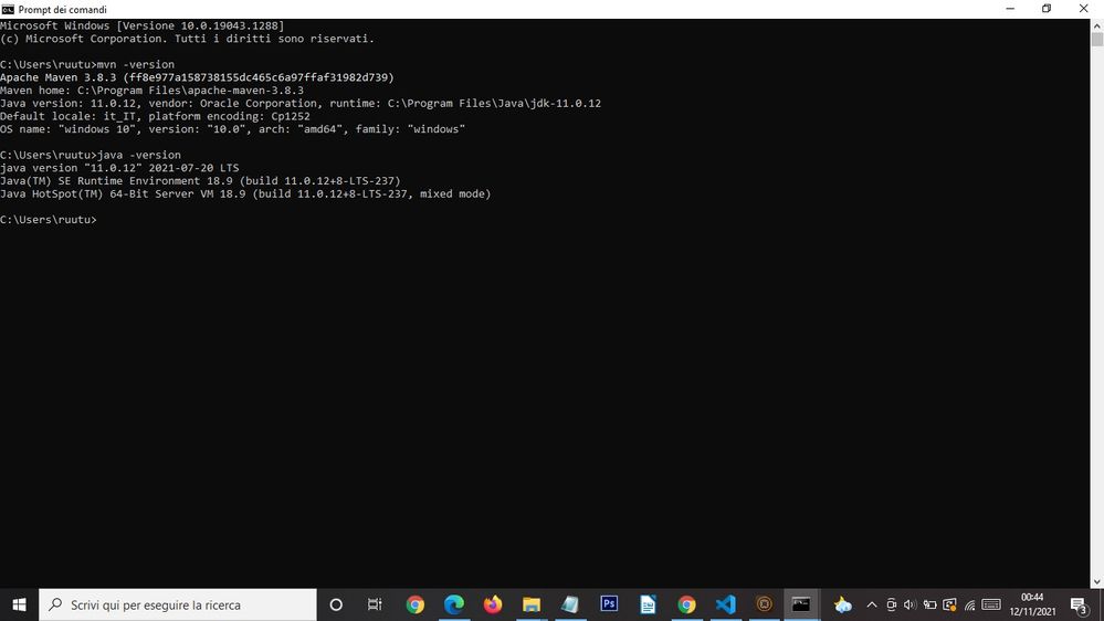

Why doesn't run?? These is my version of Java and Maven

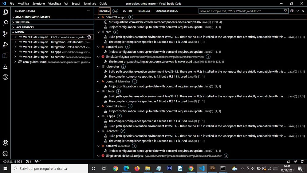

And this is  the  Output of Visual Code
Before to run at 2:23 of video i have changed The pom.xml of the file AEM-GUIDES-WKND-MASTER, from Java 1.8 to 11.0.12 (it's correct). In fact it was run correctly and installed. But with CORE results FAILURE. Can you hel me please?
Hi @FrancoBarresi
This seems to be an issue with maven not knowing your JAVA version. Find similar issue with resolution here: https://stackoverflow.com/questions/54732787/maven-tells-me-fatal-error-compiling-invalid-target-rel...
Hope this helps.
