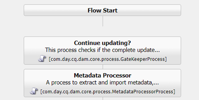

Btw, my step is after the "metadata processor" in the OOTB update asset workflow

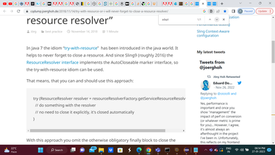

As per my understanding you don't need to close the resource resolver in this case.
Please refer these links -
https://cqdump.joerghoh.de/2018/11/12/resourceresolvers-and-sessions-you-open-it-you-close-it/
https://cqdump.joerghoh.de/2013/07/23/cq-development-patterns-sling-resourceresolver-and-jcr-session...

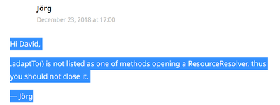

I have learnt from @Jorg_Hoh
.adaptTo() is not listed as one of methods opening a ResourceResolver, thus we should not close it.

yes, reason i confirmed is, strangely, when i tried adding the autocloseable try and the info message for the custom class disappeared. The blogs however, unless i am missing something do not speak to workflow session . I see it implemented with autocloseable try to close the session/resolver in ACS(links above) , makes me wonder if this is an internal bug for which autocloseable try, to close the session/resolver, is a workaround.. raised a ticket.. as a bug with tagid is confirmed
on adaptTo
You are correct, the code instantiates a new ResourceResolver there. My blog post is actually incorrect in that area. So you need to close this RR.
Thanks for spotting. I will update the post.
Thanks a lot @Jörg_Hoh , and please do not apologize, it is a needle in a haystack. Please do provide me with the url of the post you update and i will keep it for reference.
