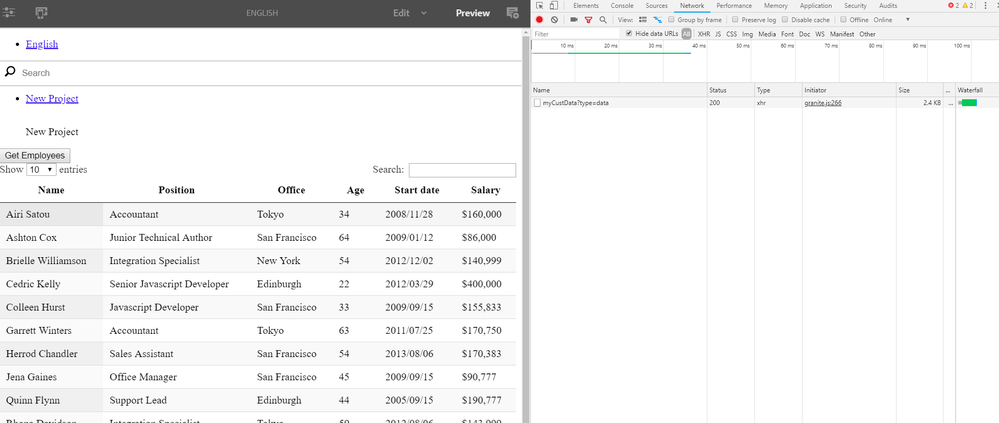

When you click the button - look at the network tab in chrome - are you getting 200 as the HTTP response.

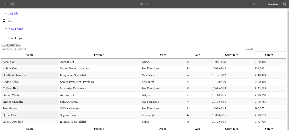

Just retested - if you follow the article - you will get this result:

So, I received a 200 HTTP response for that implementation, but I went ahead made the code consistent with the tutorial verbatim. I am still getting a 200 HTTP response but no data.
