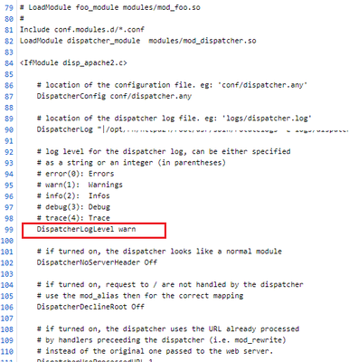

Hello @Aj_9625932
Your best friends for debugging Dispatcher issues are,
access.log and dispatcher.log
To set the Dispatcher.log to either Debug or Trace level open the httpd.conf file and look for the settings shown in the screenshot below. Save and restart apache. Tail both access.log and dispatcher.log and access the page URL in the browser. That should show you whats going on with that country link.
Hope that helps.
