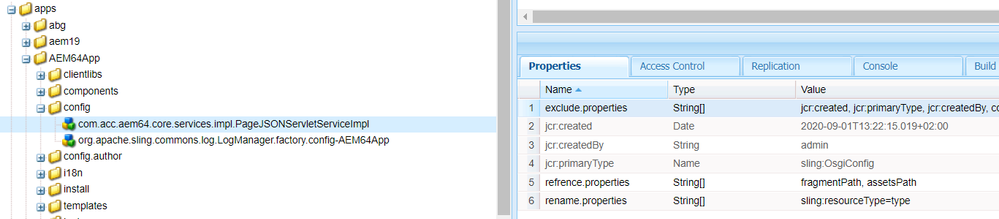

and how does your configuration look like? how do you deploy it? Is the PID for the configuration you deploy really "com.acc.aem64.core.services.impl.PageJSONServletServiceImpl"?
Hi @Jörg_Hoh
I deploy via code i.e. apps package and config look like below :
AEM LinksLinkedIn
well, that configuration looks fine and I don't see why it wouldn't work 🙂 so if @Adilmo follows this, everything should be fine.
