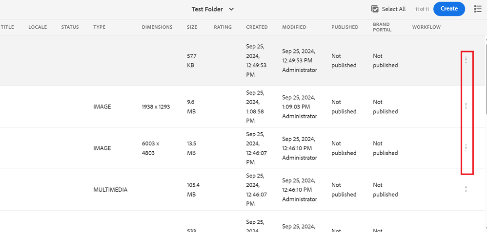

I Have a requirement like i need to re arrange the assets in card view .The re arranging of assets which is available in list view is there a way to customize same in the card view to re-arrange the assets.

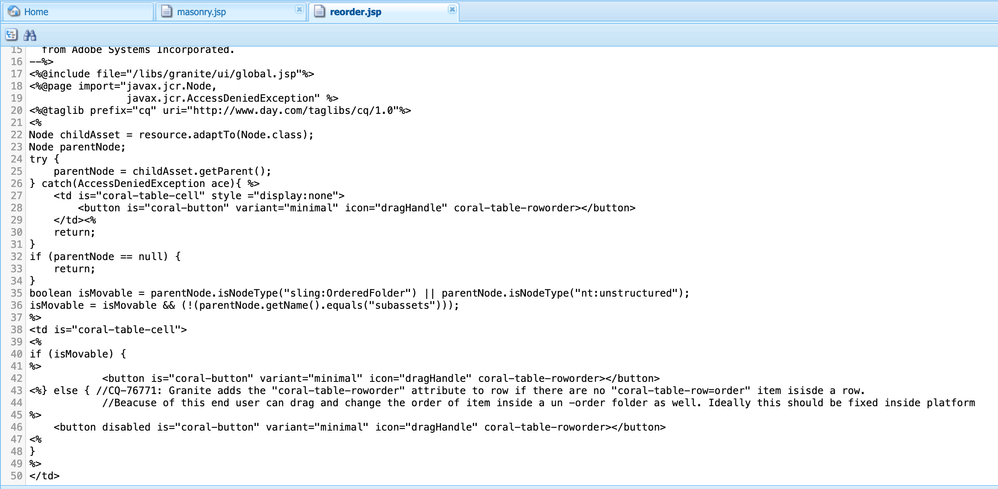

The functionality for reorder in list view comes from the below JSP as the list view is implemented as a table -
/libs/dam/gui/coral/components/admin/contentrenderer/row/common/reorder.jsp
<td is="coral-table-cell" style ="display:none">
    <button is="coral-button" variant="minimal" icon="dragHandle" coral-table-roworder></button>
</td>
The list view is implemented as a table and the reorder button is rendered via logic as shown below -
Implementing the same functionality in card view would be tricky as the card view is implemented as <coral-card> with corresponding listeners.
Hope this gives you some insight!

The issue with sorting in the list view is that the preview option is very small and difficult to see. Additionally, the functionality could be much faster and more convenient. The ability to sort in the card view will speed up the ability to set assets up as needed much quicker.
