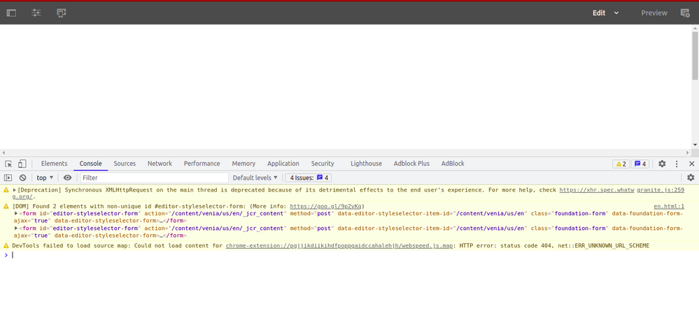

Basically, I set up AEM in Ubuntu 20.
I set up the requirement for AEM and its working fine, Next, when I thought of customizing the theme via which I cloned from the GitHub link https://github.com/adobe/aem-cif-guides-venia, as I have started as per GitHub steps first I ran
`mvn clean install -PautoInstallSinglePackage,classic`
after that, the BUILD was a success, But while editing the theme it's showing blank as screenshot attached below
When I tried with the same package in Windows the venia theme is working fine. Hereby attached Error Log for reference.

Hi @ScriptHost ,
Could you please confirm if all the bundles are in active state ?
<<hostname>>:<<port>>/system/console/bundles
Hi @ScriptHost ,
Which AEM version do you use? CIF (applies to AEM Venia as well) requieres 6.5 with SP 7 or later.
