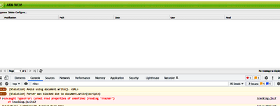

Update - OOTB 6.5.0 email and inbox notifications work , 6.5.10 none work and same with 6.5.11. I get the below error in 6.5.10
I see a missing inbox node for the profile (admin in my case).Validating on 6.5.12 and will attempt it on 6.5.9(unsure if i have the SP) but i trust your observations. I also see an error in console

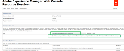

Notification servlet is active on both AEM 6.5.9 and AEM 6.5.10 as shown below -
Even I could see similar console error on both AEM 6.5.9 and AEM 6.5.10.
Taken screenshot from AEM 6.5.9 but no issue here in terms of getting notification -
