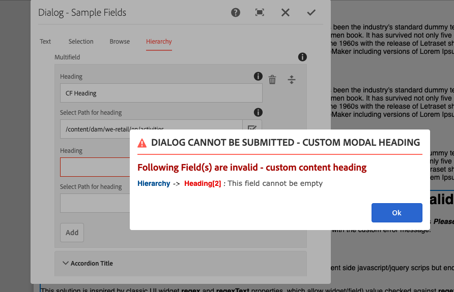

I have a multified (say, list) and within that there's a textfield (say, title) which is set as required. Now if a user adds too many multifield section(say, product1, product2, product3) and then collapses all the sections. he filled in title field in product1 and product3 and missed to fill in 1 title in produc2, then if he tries to close the dialog box, he will not be able to close the dialog box, because title is a mandatory field and it is not filled. Also at the same time since all the multifields are in collapsed, he wouldn't know in which multifield section he is having the issue. He would have to expand all the multifield sections to find out, which one is having issue. is there anyway to deal with this, so that the user knows exactly under which multifield product is the issue?

supposed, if i added many list sections and only in 1 list section i forgot to add the title (which is mandatory), i wont be able to close the dialog (without filling the mandatory field). And since i collapsed all the items, i dont know exactly where the issue is. So i have to open every section and check. Wheni expand all section one by one, i get to see my title field in read (which i forgot to fill in). Refer the image below:

Just a hint, how can you display the exact field occurance in the popup
https://aemlab.blogspot.com/2019/05/aem-touch-ui-component-dialog-field.html
