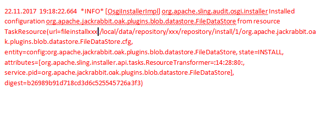

On comparing the error logs of both the instance I can see an extra log in Instance 1(Working) which is not available in Instance 2(Not working) , attaché below for reference

Above logs is something related to working instance , where is in non working instance I can't see (info log )org.apache.sling.launchpad.installer , org.apache.sling.installer.provider.file  showing as registered ,starting in error logs. Though the bundle is active if seen from system console.
