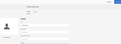

Issue creating local users
Has anyone come across a problem when creating a local user within an AEM Author instance?  The user appears to be created, is visible in the repository, under /home/users, however cannot be located in any search?
Once thing I have noticed, is that the user node under /home/users, for a working user, has child nodes: .tokens, preferences, profile and rep:policy
For users that cannot be searched, only profile and rep:policy child nodes are visible in the repository.
I am using AEM version 6.5.11.
Any help would be appreciated
Many thanks in advance

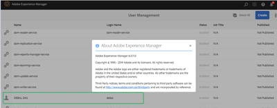

I have created user named: debal in AEM 6.5.11 as shown below -

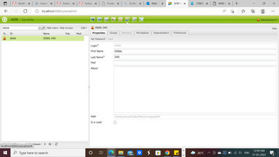

Useradmin -

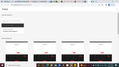

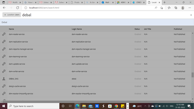

Using search bar -

Please try to search that user using useradmin console as shown below -
