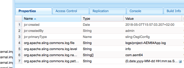

you can use Apache Sling Logging Logger config, where values store and name has period.
If you want to create names for Osgi config properties like above org.apache.sling ... with dot  , you can use "_", It will be converted into dot.
The AttributeDefinition method naming convention will immediately seem out of place. It's very Pythonic looking with its use of underscores. You don't need to write your method names that way, but the reason for doing so is that the underscores are converted to dots for display in the Felix console and your OSGi configs. For example, you're probably familiar with seeing properties defined as something like resource.resolver.searchpath. To achieve this in your configuration class, your method would be named resource_resolver_searchpath.

so i figured out the issue, i see that the name being stored by the prev developers was com..test.core.abc.appid. How do i set this to a configuration in 6.4? I don't believe we could have a string with period as the name ?
I don't know if I understood your above query correct or not.
You want to save appid config value in repository based config?

Thanks Arun, followed above steps and have it working now., Appreciate it
