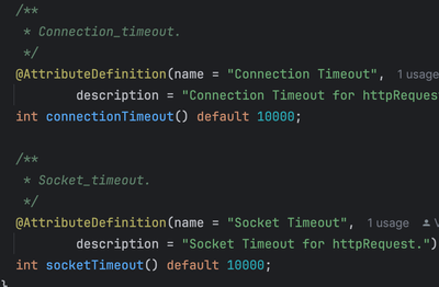

Hi @vjleo94 ,
Hope you may have given some default integer value for connectionTimeout in config class if not you may try.
Or it might that scan is not that intelligent to go to 2-3 level then you may need to directly set the timeout.
Hi @MukeshYadav_ ,
The values are set in config. The later seems to be the case. It only seems to scan the first level.This results in redundant code as I have to add in each class.
Hi @vjleo94 ,
did you tried scanning after adding default values like this in config class?
