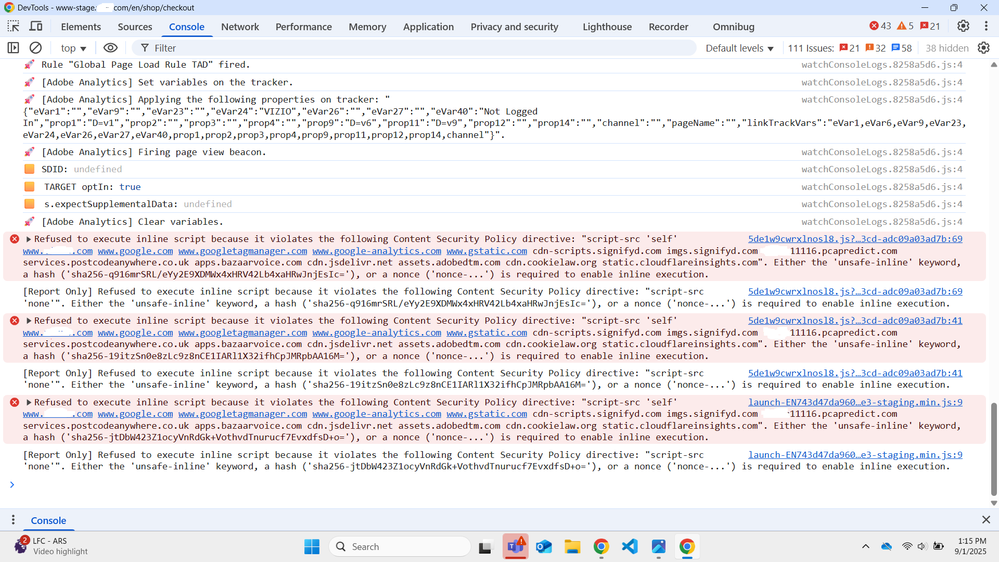

Recently, I've seen this CSP issue and its pretty new to me and I've no idea how to fix this issue. Step by Step guide is really appreciated.
Need your guidance on how to fix this issue..

It says that there a csp defined "Script self" which allows the javascript execution from js loaded from your domain itself and it blocks other js files which are executed from different domain.
If you really want other domain js files to be executed then you need to allow the other domain in your csp rules.
Check your csp rules at CDN or dispatcher and update the rules as
Content-Security-Policy: script-src 'self' https://www.xyz.com
If you update your rule as above then it allows js execution from xyz website.

I reviewed several blogs that suggested placing the embed code in the <head> (<meta http-equiv="Content-Security-Policy" content="default-src 'self'; script-src 'self' https://assets.adobedtm.com https://www.googletagmanager.com https://www.google-analytics.com https://cdn.cookielaw.org;">) tag, but it didn’t work for me.
Could you advise whether this should be implemented through Adobe Launch—via Data Elements or Launch Rules? A step-by-step guide would be really helpful, as I’m not fully sure of the exact steps.
