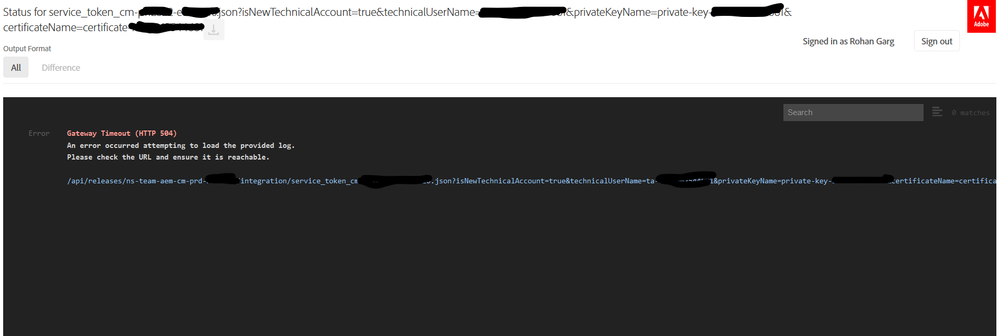

Hi AEM Community,
I am following the below documentation to generate Access Tokens using Developer Console-
https://experienceleague.adobe.com/docs/experience-manager-cloud-service/content/implementing/developing/generating-access-tokens-for-server-side-apis.html
The below step is not working for me -
  • Clicking the Create new technical account button, a new set of credentials will be created that includes client id, client secret, private key, certificate, and configuration for author and publish tiers of the environment, regardless of the pod selection.
A new browser tab will open up displaying the credentials. You can use this view to download the credentials by pressing the download icon next to the status title:
I am able to generate the local development token but not the access tokens.
Any help on why HTTP 504 will come up? (Associated with server, while acting as a gateway or proxy, did not get a response in time from the upstream server that it needed in order to complete the request)

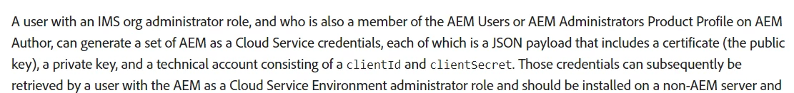

Update -
Also checked the documentation mentions the below -
IMS Org Admin User or any user with AEM Admin Profile can create the credentials.
I tried with System Admin role and it worked!

Fetch the AEM as a Cloud Service Credentials
Users with access to the AEM as a Cloud Service developer console will see the integrations tab in the Developer Console for a given environment. A user with the AEM as a Cloud Service Environment administrator role can create, view or manage credentials.
As per the documentation the environment admin create credentials. The IMS org admin is part of AEM Admin Product Profile.
