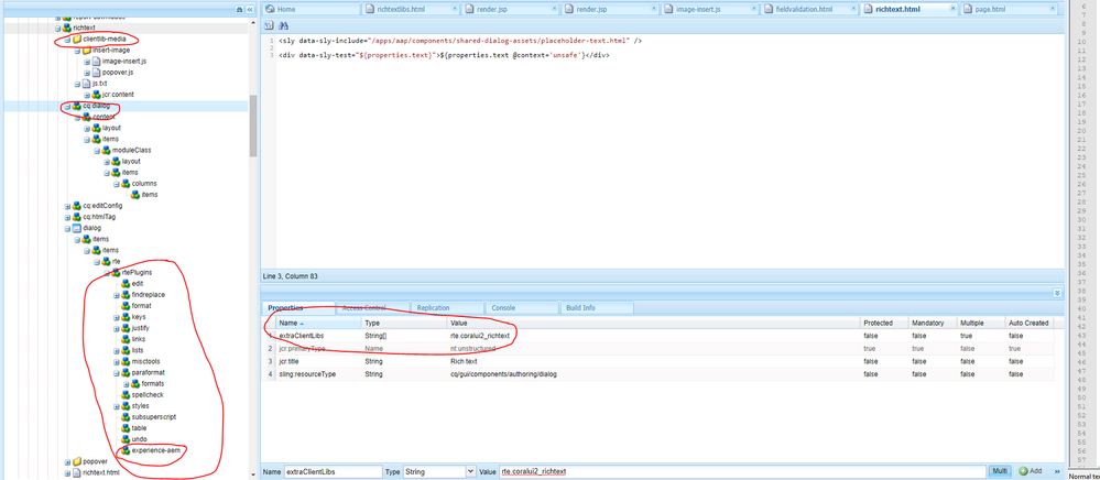

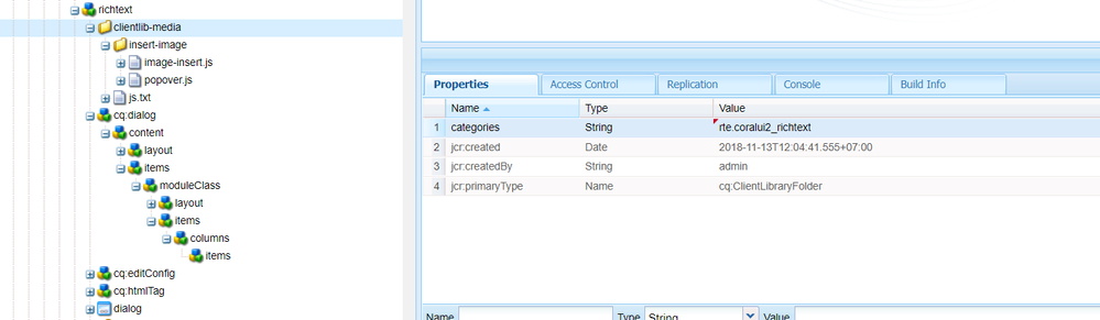

Did you mean as below?
The clientlib-media with categories rte.coralui2_richtext
I added extraClientLibs(String[])=rte.coralui2_richtext in cq:dialog
The experrience-aem node is image note, which display icon in rte.
I am tried it but it doesn't work.
