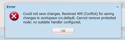

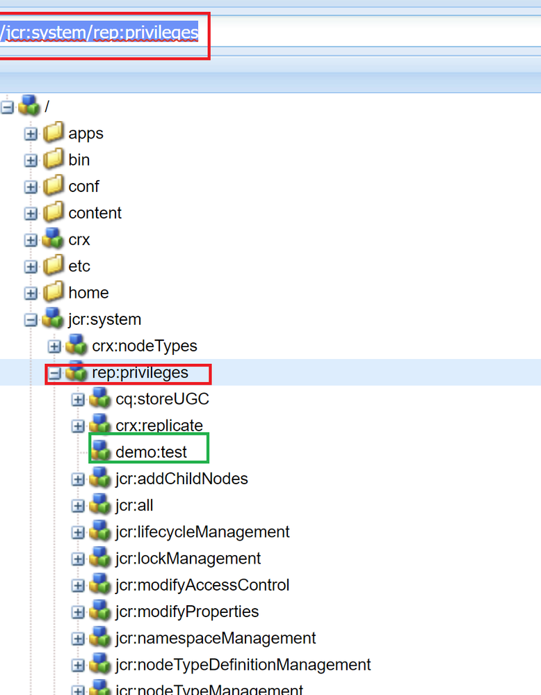

Hi @Vijayalakshmi_S,
I created a brand new privilege on Vanilla and thus it is not been assigned to any user/group for any path.
It doesn't allow me to delete the privilege directly from crx /jcr:system/rep:privileges.. Gives the below error when i try to save.
Also through the crx/explorer->Content explorer, it disables the delete option for /jcr:system/rep:privileges.
Please let me know if there is any workaround for this.
