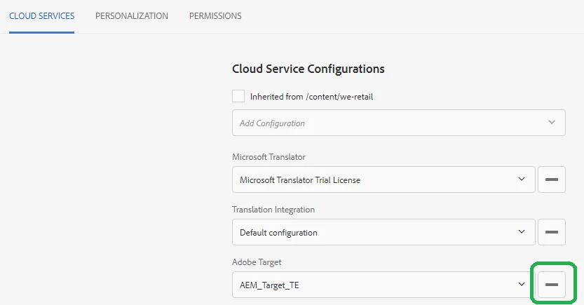

Hello folks,
There are many articles on how to integrate Adobe Target, but I could not find any explaining how to correctly delete the integration. I wonder if you could share your experience on the following?
  1. How to unpublish the integration from all site pages?
  2. How to deactivate and delete all activities? Is there a bulk approach for that?
  3. How to delete all audiences?
  4. How to delete the integration?

1.How to unpublish the integration from all site pages?
KS: Go to the PageProperty of the Site/Page -> Cloud services -> Remove Adobe Target config

1. I tried that method, but after unpublishing the root page the cloud service was setup for (e.g. we-retail) the JS libraries kept working on Publisher. Is there anything else needed to be done unplug the integration?

4. If your use-case is to only turn off the Targeting from the site then Go to the PageProperty of the Site/Page -> Cloud services -> Remove Adobe Target config. No need to delete connector configuration. But you can go ahead and also remove it if you want. It should not create any issue.
