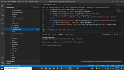

Hi @infiniteshi ,
Kindly Check whether your using the extension i had showed in below screen shot and also make sure it as necessary access rights configured,In my case it was using default admin access.
It works fine for me see below references

Hi @infiniteshi ,

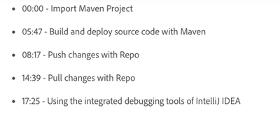

@infiniteshi You can follow below videos where you can find step by step details on how to sync code between AEM & Intellij/Visual studio/Eclipse. I always follow this doc and works for me 🙂
https://experienceleague.adobe.com/docs/experience-manager-learn/foundation/development/set-up-a-loc...
Time stamps:
for Intellij Repo setup: https://github.com/Adobe-Marketing-Cloud/tools/tree/master/repo#installation
Once you setup Repo, then you can easily sync content between.
Hope this docs help you.
