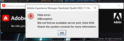

Facing error while starting AEM in Debug mode.
Below is the command used to run AEM in debug mode
java -Xmx2048M -agentlib:jdwp=transport=dt_socket,address=8888,server=y,suspend=n -jar aem-author-p4502.jar

Hi @anilkumar9
Not sure, why are facing the issue, even though you are using the proper command. I have tried this way.  Added these in the start.bat file.
Then. opened the command prompt in bin folder > start.bat
if not defined CQ_JVM_OPTS set CQ_JVM_OPTS=-Xmx2048m -XX:MaxPermSize=512M -Djava.awt.headless=true -agentlib:jdwp=transport=dt_socket,address=8000,server=y,suspend=n ::* add the required JPMS modules, if needed java --add-modules java.se.ee --version > nul 2>&1 if %errorlevel% EQU 0 set CQ_JVM_OPTS=--add-modules java.se.ee %CQ_JVM_OPTS%

Open command prompt and go to same folder where jar file is present as shown below and run below inline command
java -jar cq65-author-p4502.jar -fork -forkargs -- -Xdebug -Xrunjdwp:transport=dt_socket,address=30303,suspend=n,server=y -Xmx1500m -XX:MaxPermSize=300m
Please check the highlighted port name.
Note: Restart system it will work as your instance didn't get shutdown or wait for sometime.

@anilkumar9
Can you check if you are already running an AEM instance on port 4502 or if any other process is using port 4502
If yes, try to kill the process and then try
