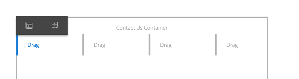

I have a column control component in AEM 6.4. Th a parsys in this column control shown below is added like this :
<sly data-sly-resource="${'one-column' @ resourceType='wcm/foundation/components/parsys'}" data-sly-unwrap="${!wcmmode.edit}"></sly>Screen Shot 2018-11-29 at 2.13.36 pm.png
I want to drag a component in this but it only gives me option to add experience fragment.How can i make sure that I am able to add component in this and not just experience fragments.

I have dragged and dropped this component on page and hence the parsys in the template in which this component is dragged I allowed all component from policy but now since this component has parsys of itself  I was thinking how to handle this parsys on page level enable it to add component.
For this we don't need to do anything on template level right because I want this component individually on page level.
