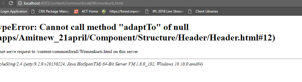

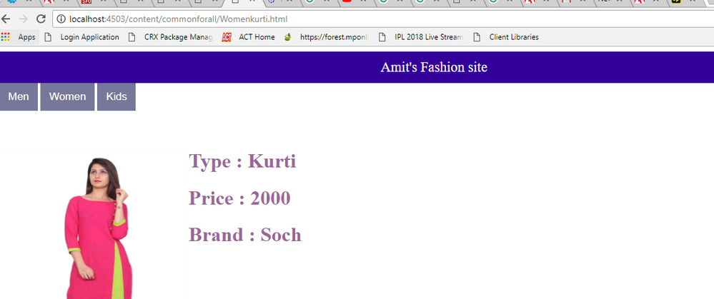

From publish instance when i hit my site page which is localhost:4503/content/pagemane.html...it works fine in coginitve mode of chrome but it throw 5oo error and said adaptTo mechanism erroe soe null error ...how is it possbile in coginitive mode page is
Level 7
said adaptTo mechanism error null error ...how is it possible in coginitive mode page is working fine but in incogintive mode it throws error.
In incoginto mode:
error2.PNGerror3.PNGis it
pos
Level 7
This scenario usually occurred when your code is depend on user session.
It look like you are already logged in on browser in normal mode that's why you don't get error.
Try login incoginto mode and you should have get same response.
In case doesn't work , share error logs.

Level 7
Hi Brijesh ..thanks for answer...what does ir mean when you say code is depend on user session....please can you elobrate ..it would be helpful for me ...and yes i was logged in in publish instance in cognitive mode ..bt incogintive mode of chrome i just tried to run my that page only ....
For the line it is hwoing error dat izz some thing related to sling api adaptTo method i used ...in logs for incognito mode it is shwoing like null values jz coming and for cogintive mode it works fine ...so no error type log ..
Level 7
It means that something you are try to inject or access in you code which is not accessible in publish with anonymous user access.
/Brijesh
Level 7
Hi Brijesh ..thanks that hepls ...It was showing error because i have not given the permisson for  etc/tag for anonymous in publish.
After giving the permission i can open in different different browser and in incoginto mode as well.
