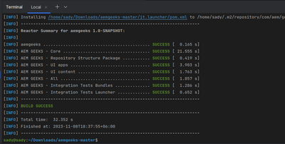

Hello @vineetham123 ,
Maybe you are talking about the master branch. I didn't find the 'main' branch.
However, I tried to do the same in my local. Unable to generate this issue.
You can do one thing, In your local .m2 delete the biz.aQute.bnd folder and let Maven install it again. Then try to install the project again.
