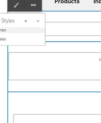

Hello, We are using AEM 6.3.3.6. Parsys is unlocked. We are not applying style system to the parsys but the components inside the parsys.
The component has the design dialog which works when the component is dragged into the parsys in the template under the same parsys.
However, instead of that if we drag and drop the component in the unlocked parays on the page (not template) then the option style system option does not appear.
