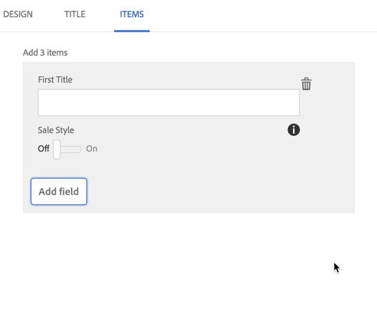

Attached images of implementation.
Added the multifield.
Added the boolean type switch
This is the dialog.
Adding values to the dialog. 1st is true, 2nd false and 3rd is true.
It stores everything as true 😕

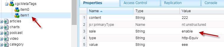

I tried setting custom value to switch as replied to BigT168 in above post but got the same value in all of them in crx.
{"firstTitle":"T1", "sale":"enable"}
{"firstTitle":"T2", "sale":"enable"}
{"firstTitle":"T3", "sale":"enable"}
instead I would expect it to be :
{"firstTitle":"T2", "sale":" "}

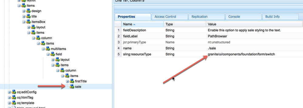

This is the definition of the dialog:
<jcr:root xmlns:sling="http://sling.apache.org/jcr/sling/1.0" xmlns:cq="http://www.day.com/jcr/cq/1.0" xmlns:jcr="http://www.jcp.org/jcr/1.0" xmlns:nt="http://www.jcp.org/jcr/nt/1.0"

I think you use mix the foundation class, one with coral and one without coral. I add the sale into my dialog, it works for me. The value is false by default otherwise it is enable.
If you use all coral foundation class in the dialog, the multifield will store each one as node instead string array.

Hi BigT168, the issue was with eaem-multifield=“” for coral ui 2. It should be acs-commons-nested=“” in the dialog above when using coral ui2 components.
Coral UI 3 makes it in a form of node and Coral UI 2 keeps it in json format and I wanted it in json.
