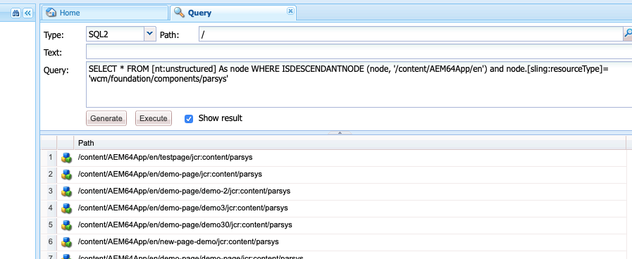

I tried with your content structure, working for me in my local instance.
I think you can raise a Day care Support Ticket to get it resolved.
I ran your query in AEM64, it I giving me results. Can you please check the sling:resourceType property in page content nodes.

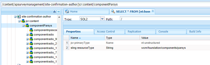

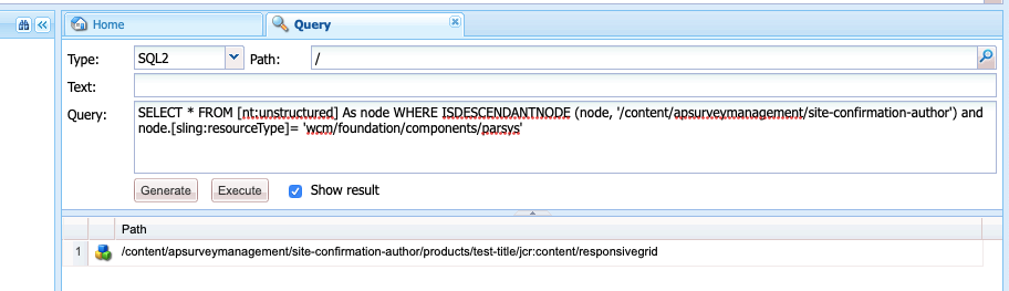

Thank you for the reply. But unfortunately this still doesn't work for me. I am able to query nodes in another project based on the sling:resourceType value. I am not sure if it is project related. Ideally, I don't think it will be.
I am sharing screenshots of the query and it's response. I am also attaching a screenshot of the node that should ideally be returned.Am I doing something wrong here?
