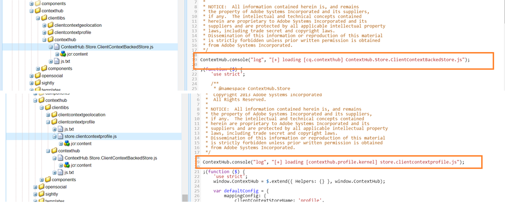

I am working on a similar issue and noticed this issue was caused by the syntax error at line 31. It should be :
ContextHub.console.log(ContextHub.Shared.timestamp(), '[loading] cq.contexthub - store.clientcontext-backedstore.js (clientcontext connector)');
There were extra quotes around the console."log" which was causing the issue. Try checking if that is the case here.
[1] /libs/cq/personalization/contexthub/components/stores/clientcontext-backedstore/store.clientcontext-backedstore.js
In below files also instead of using "ContextHub.console.log()" they committed ContextHub.console("log","") which causing "ContextHub.console is not a function" error.
can you please fix them
  1. /libs/cq/personalization/contexthub/clientlibs/contexthub/ContextHub.Store.ClientContextBackedStore.js
  2. /libs/cq/personalization/contexthub/clientlibs/clientcontextprofile/store.clientcontextprofile.js
