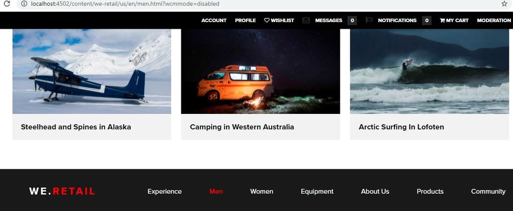

Hi Vijayalakshmi_S,
Tried above steps on our site page but couldn't see icons visible on page. Tried same on we-retail page again but with that also same issue, icons are not visible.
After authoring proxy component created of social sharing core component on page, Enabled properties on Social Media Tab of the page & 'View as published'. can see Metadata properties of og:url, og:image & og:title etc but not the icons.

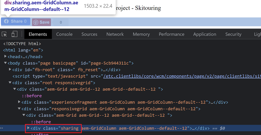

Now for icons not displaying, can you inspect  the page in the place where you have authored(in "view as published") and check if the component markup for sharing is evident in "Elements" section of Developers console.

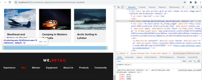

Hi Vijayalakshmi_S ,
Have used proxy component only initially as well not the core. After inspecting the place where component is authored can see the element like in below screenshot, not sure why its not shown up on page.
