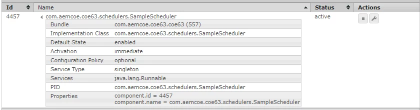

Additionally, I do see the OSGi DS Component get registered, but it doesn't get a Service PID or show the meta properties.

So the values are definitely different. Interestingly, I copied the example Arun provided and it has the same problem as my example with OSGi DS annotations, but it did show some extra properties provided below. I'm guessing most people don't see this problem during development because they are utilizing the system console to play around with the configurations. Once a configuration exists the task is scheduled and there isn't an issue, but in higher environments where access to modify configurations in that way is restricted or disabled this can cause problems.

OSGI DS
<scr:component configuration-pid="com.aemcoe.coe63.schedulers.SampleScheduler" immediate="true" name="com.aemcoe.coe63.schedulers.SampleScheduler" xmlns:scr="http://www.osgi.org/xmlns/scr/v1.2.0">
    <implementation class="com.aemcoe.coe63.schedulers.SampleScheduler"/>
    <service>
        <provide interface="java.lang.Runnable"/>
    </service>
</scr:component>
Arun's Example: (Note it doesn't include scheduler.expression for some reason even though its defined)
