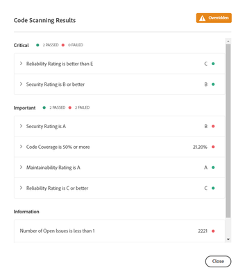

When I execute the pipeline to deploy my software to DEV and the code scanning step finishes, the porcentage of code coverage is much lower is the pipeline than in my local IDE.
Can anyone explain me where is the difference or what am i missing?
I have attached two snapshots, one from pipeline and another from my IDE. Thanks in advance.

Your IDE will generally only calculate the line coverage but cloud manager also takes into account the conditional coverage to calculate the final value which is generally the reason for difference.
Formula which they use :
Coverage = (CT + CF + LC)/(2*B + EL)
  • CT = Conditions that have been evaluated as true at least once while running unit tests
  • CF = Conditions that have been evaluated as false at least once while running unit tests
  • LC = Covered lines = lines_to_cover - uncovered_lines
  • B = total number of conditions
  • EL = total number of executable lines (lines_to_cover)
Formula Copied from below link
https://experienceleague.adobe.com/en/docs/experience-manager-cloud-service/content/implementing/usi...
If you have jacoco configured in your project then you will get better reports when you run the build using maven.
