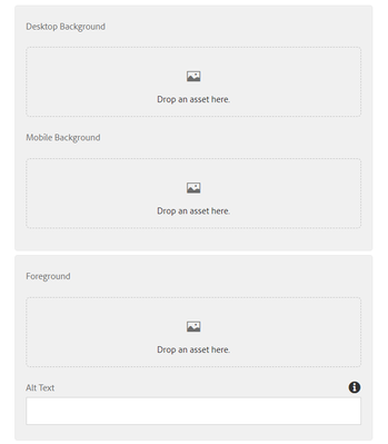

Sorry for the confusion. It's not within multifield. Assume, I have two fileupload fields, one for uploading image for desktop and another one for mobile.
@webdev91 You could actually use multifield with an additional viewport dropdown to indentify images specific to view ports.
Hi @Manu_Mathew_
I definitely liked that idea, but unfortunately, that still doesn't solve our problem. Please refer to the below screenshot. We have a complex hero banner, that's where we are authoring all those images.
@webdev91 Can you describe the problem you are facing and also could you share the dialog xml too.
