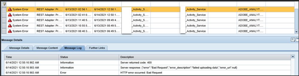

We are able to generate successfully the token and correctly added in the headers (using SAP PO), but when posting to: https://api.omniture.com/admin/1.4/rest/?method=DataSources.UploadData , AA is not accepting the data.
Is there something to be enabling at https://api.omniture.com/admin/1.4/rest/?method=DataSources.UploadData to accept the JWT token from SAP PO or in SAP PO?

yes, that was done. Rightly done. SAP PO is supported, correct?

@isabelmayo  What's the error you're getting? Is it the authorization error? Try it with postman to see if it can be SAP PO issue?
