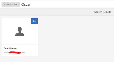

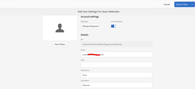

I'm trying to set up AEM SSO authentication with Azure and on top of that, I'm also trying to synchronize attributes (which works just fine. I'm using Adobe Granite SAML 2.0 Authentication Handler to achieve that), after the Azure SSO authentication ends successfully. A user with synchronized attributes is created in AEM User Management section (as expected.) The thing here is that every time I authenticate the same user, new users are created with the same data (email, name, lastname). The only difference among them is their ID.  Am I missing something like setting a constraint to avoid records with the same data?
This is how the duplicated records look like.

After doing a research and reading other posts, I noticed I had left the UserID attribute empty. (that's the reason why user records have a random string as ID and more than one user can have the same synchronized data)
