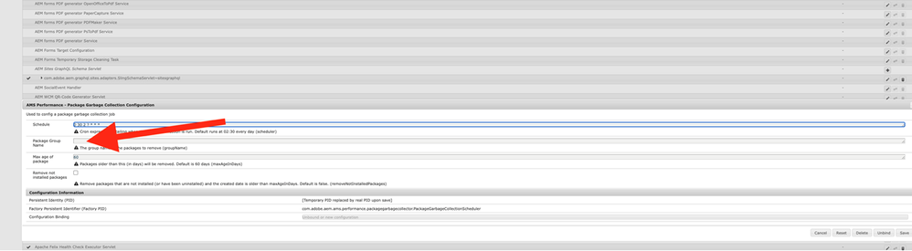

Thanks. Actually I think my problem was that I configured the package garbage collector via a OSGi config file. When i ran it manually from system/console/configMgr it worked o.k.
In reply to Muhammed's PM,
This is the OGSi system/console/configMgr entry for garbage collection that you can run.
