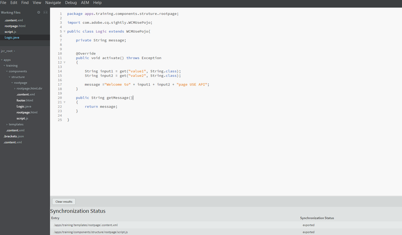

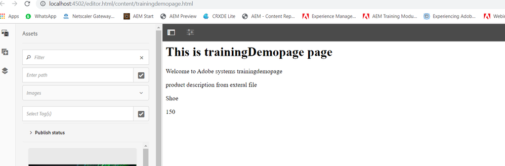

i have created a training project package and imported in Brackets IDE , synchronization is sucessfull to AEM and i am able to export back to AEM.
all statement is executing except java class , i am not seeing any error also.
AEMhtmlpreview.PNGHTML AEM UI Page
JAVA Class file
javaclass.PNGJAVA CLass file

... Did you compile the code?
It doesn't look like it.
From the screenshot -- on the left side in the structure pane -- you can't just put .java files inside the content repository and expect it to run. That's not how this works.  Java source needs to be compiled into its CLASS file and those are all magically assembled into a JAR file (an executable program) that adheres to the OSGI specification so it can run inside AEM.
Your Java code needs to be in an AEM maven project and compiled into a deployable artefact.

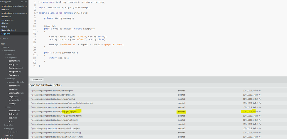

Actually I'm going to correct myself as I believe you can have Java classes that extend WCMUsePojo within the content repository.
Hi arunk85184451
I have checked this using aem bracket plugin. I can properly see Java classes in Sync status of bracket.PFB the screenshot
Could you please check it again making sure to use the latest version of Bracket and AEM plugin?
Arpit Varshney
thanks , it helps
thanks arpit
yes i can see the same its getting exported correctly from Bracket to AEM

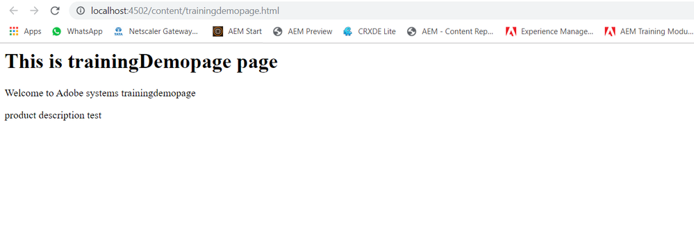

the moment i give the java class reference in html component of the page i.e it displays the output before the java class reference and stops
any help on this to debug will be helpful
thanks
There is an issue with your HTL code.
Please refer below for correct code -
<div data-sly-use.logic="${'Logic' @value1='Adobe', value2='Systems'}">${logic.message}</div>

thanks , its fixed
